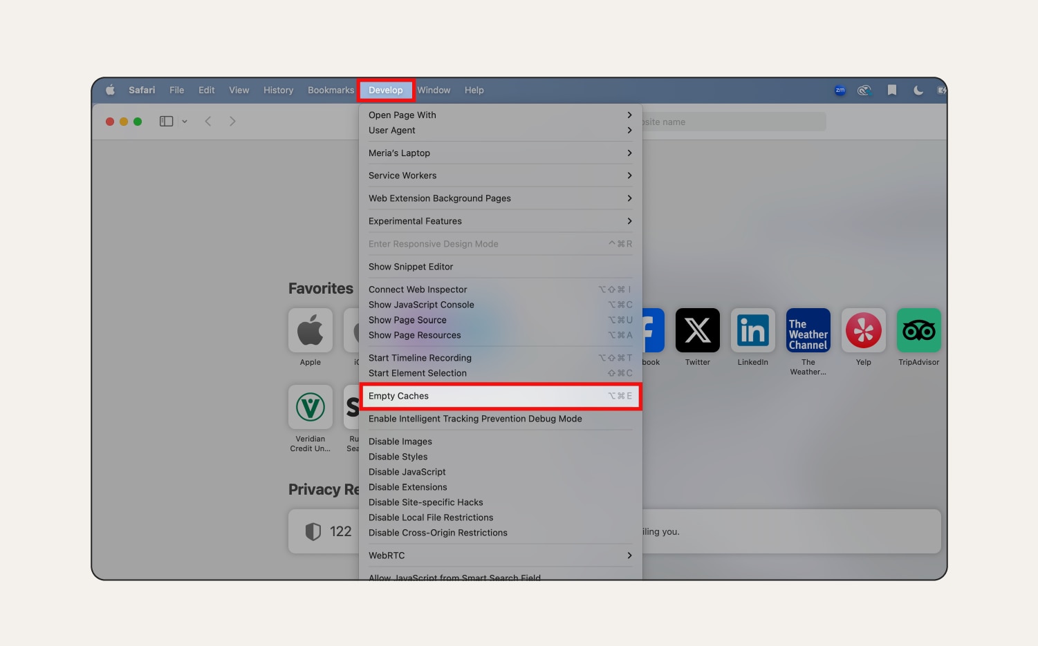

How to clear the cache on Mac Safari
Clearing out browser caches like those in Safari can enhance your online experience and ensure you’re seeing updated website content. Cleaning cache can also help with loading issues and display problems. But it can also remove session cookie and login data, meaning you’ll need to log back into sites you frequently visit.
Here’s how to clear cache on Mac Safari:

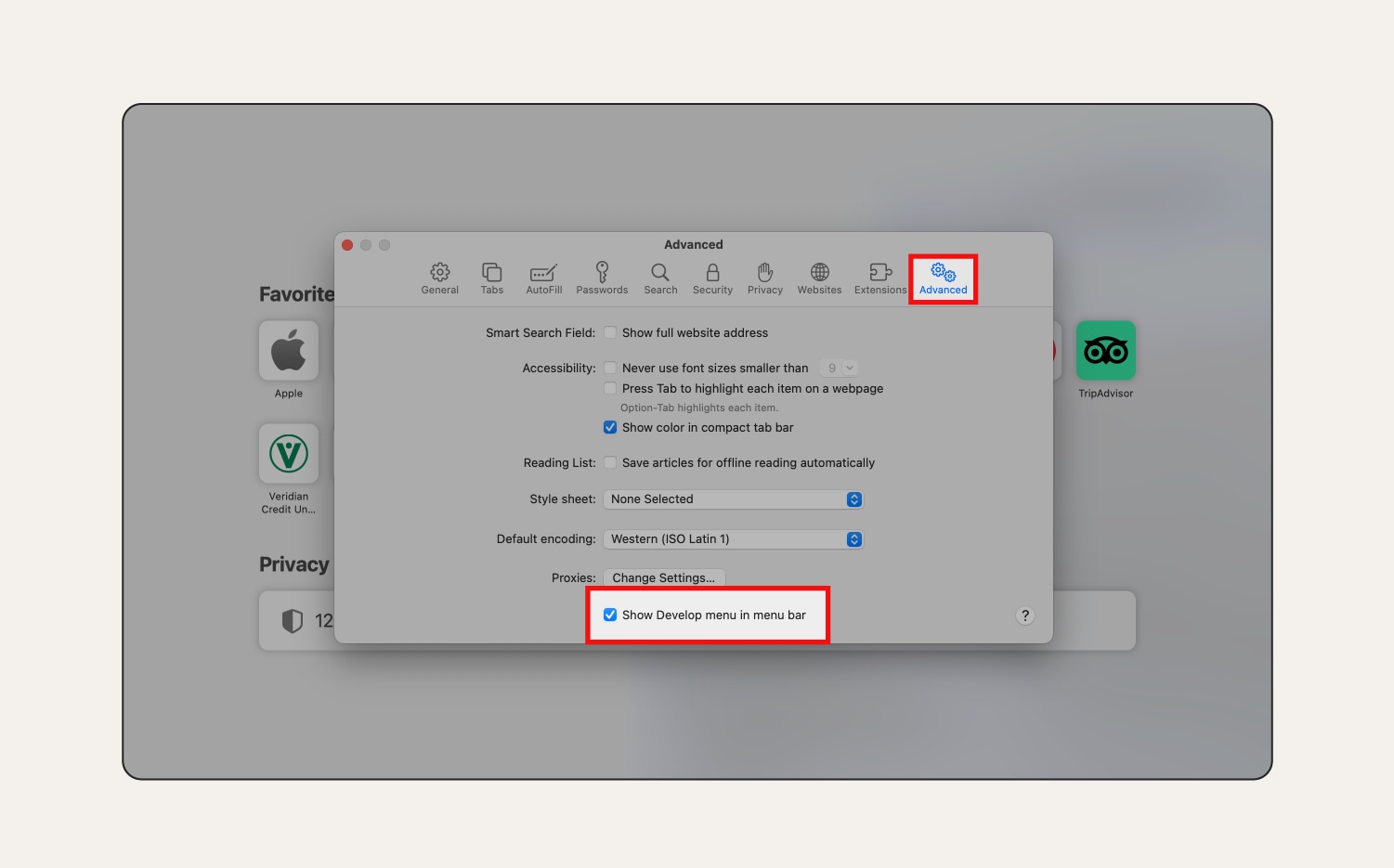

1. Open Safari, click Safari in the menu bar, then choose Settings.
2. Click Advanced and check the box to the left of Show Develop menu in menu bar (Show features for web developers on newer macOS versions).
A screenshot of Safari’s Advanced settings.
3. Click Develop in your Mac’s menu bar, then select Empty Caches.

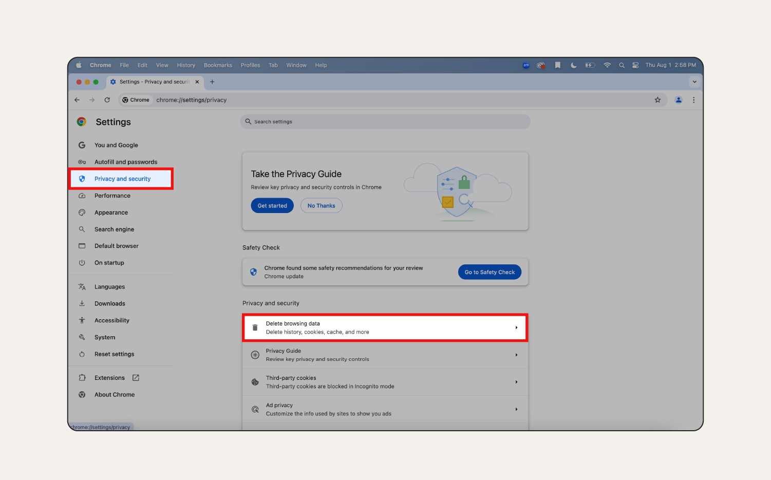

How to clear the cache on Mac Chrome
Next up, here’s how to delete cache and cookies in Chrome on Mac:

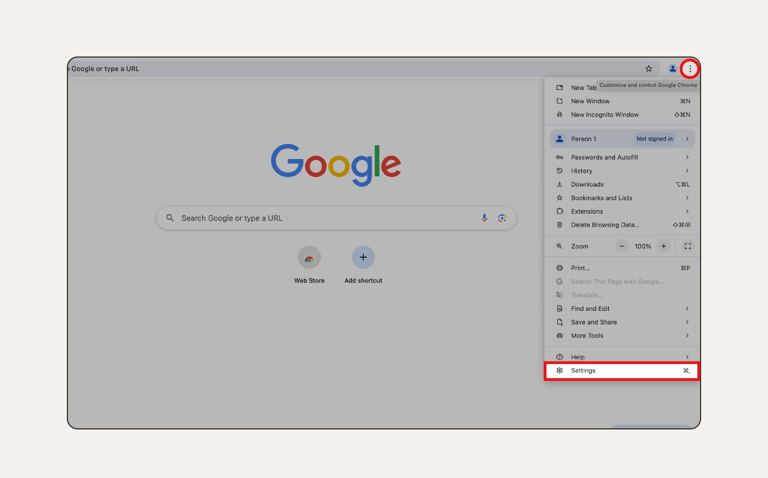

1. Open Chrome, click the Chrome options icon (three vertical dots), then choose Settings.
A screenshot showing how to open the Chrome options menu.
2. Click Privacy and security > Delete browsing data.

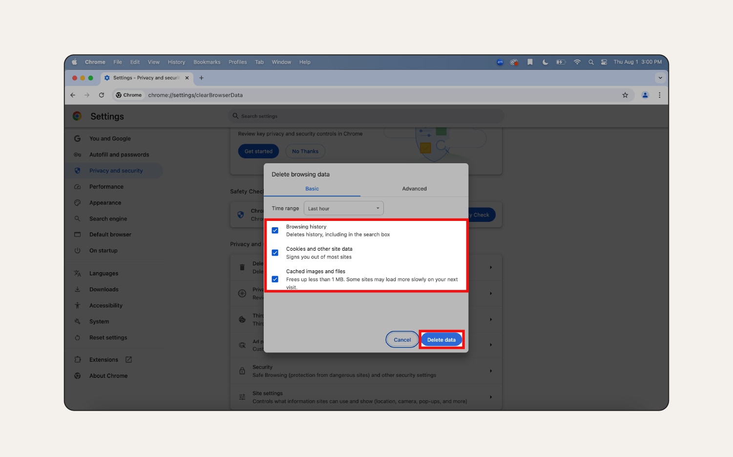

3. Select the drop-down menu beside Time range to choose from when you want to erase cache. Select Browsing data, Cookies and other site data, and Cached images and files. Then, click Delete data.

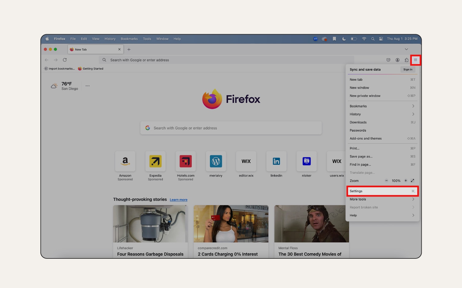

1. Open Firefox, click the Application menu (three horizontal lines), and choose Settings.

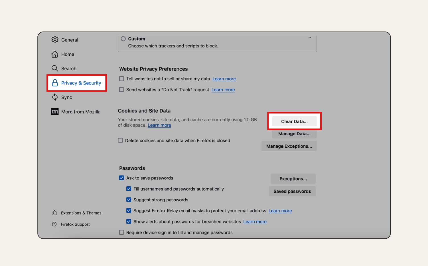

2. Select Privacy & Security. Then, scroll down to Cookies and Site Data, and select Clear Data.

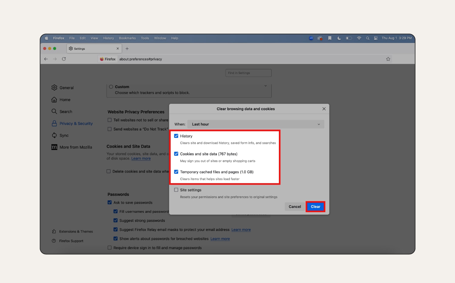

3. Use the drop-down menu beside When to determine how much data you want to clear. Check History, Cookies and site data, and Temporary cached files and pages, then click Clear.

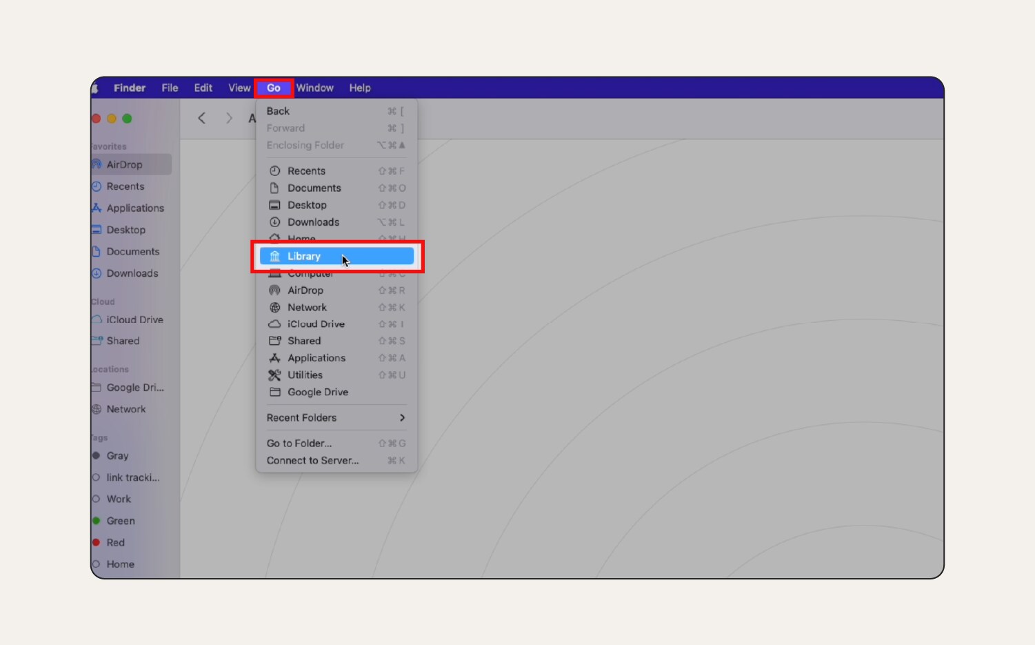

How to clear system cache on Mac
The system cache on your Mac is a temporary storage area where frequently accessed data like system files and settings live. This cache helps improve performance by aiding quicker information retrieval, but you may need to clear it if you experience problems after a system update, or if you notice a buildup of outdated files.
Only delete relevant cache files within the parent folders, not the whole folders, and be careful not to delete critical system files as this could disrupt the macOS functionality. Always back up your Mac before clearing any system cache.
Here’s how to delete system cache on your Mac:
1. Open Finder and click Go in the menu bar.
2. Hold down the Option key and click Library.

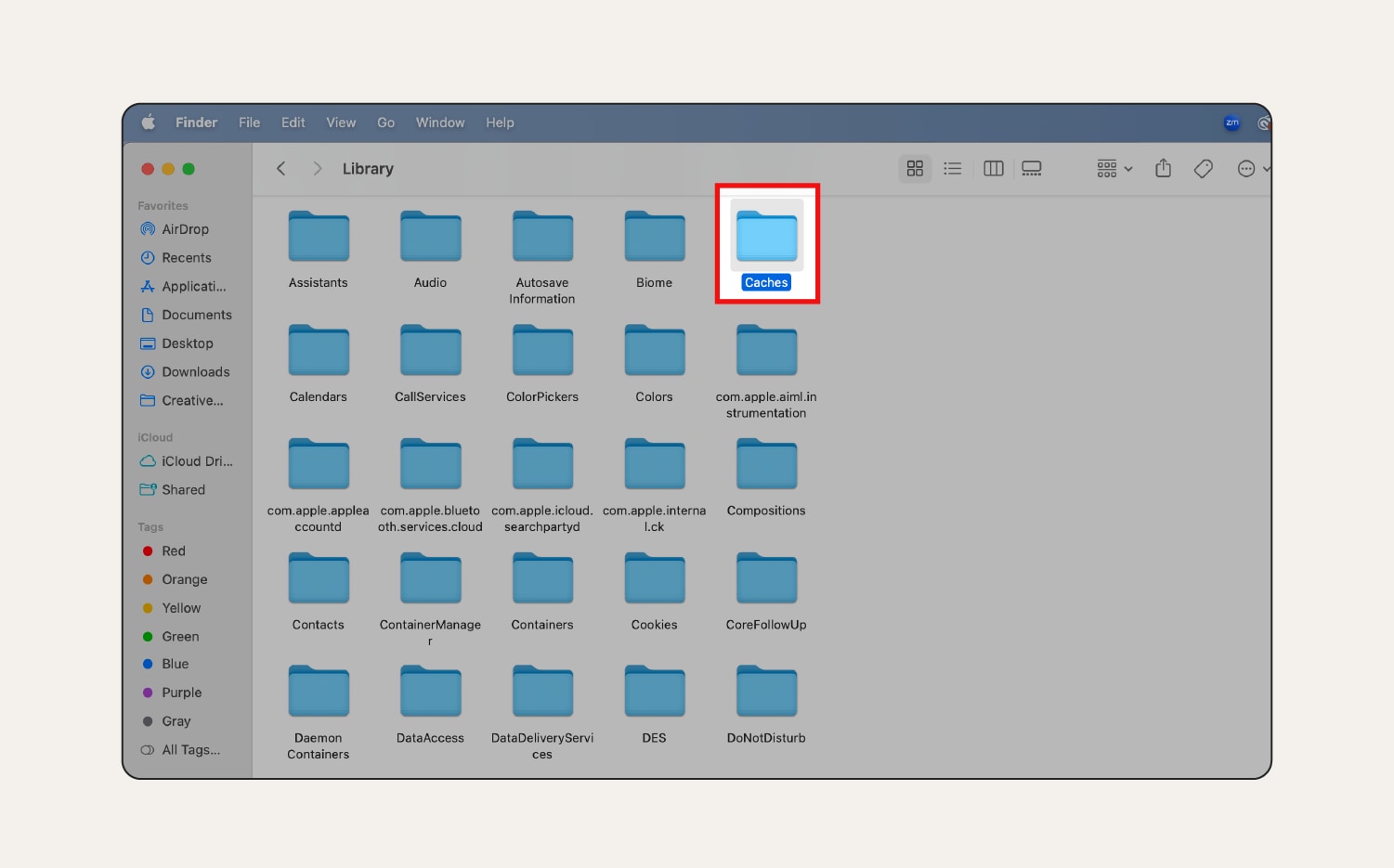

3. Open the Caches folder and look for cache files or folders related to system functionality (e.g., com.apple.systempreferences). Move any files you want to delete to Trash.

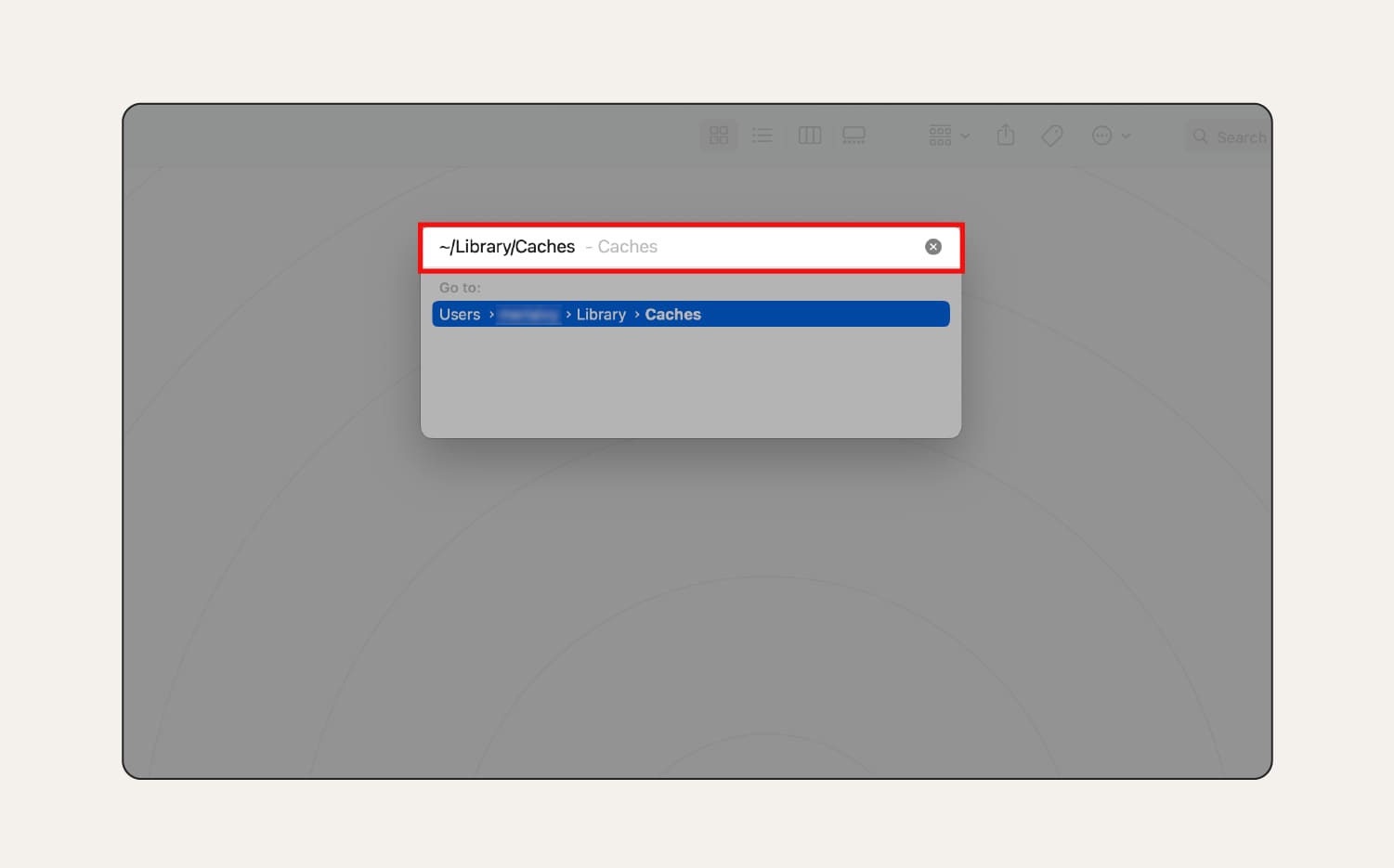

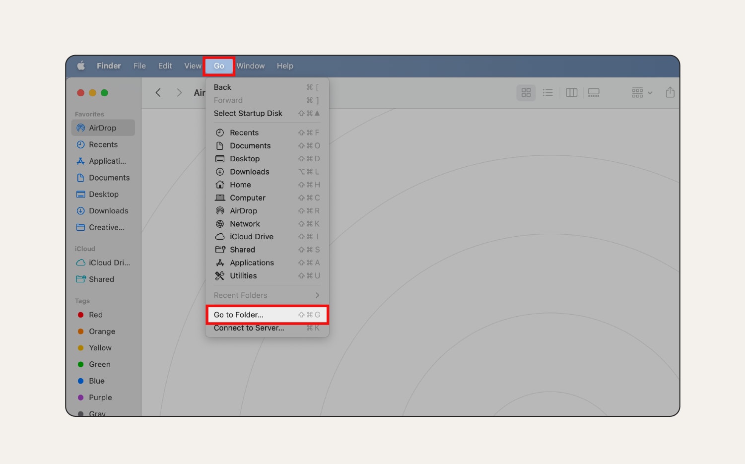

1. Open Finder, click Go, then select Go to Folder.
A screenshot of the 'Go' menu.
2. Enter ~/Library/Caches and select the result that says Users > [yourusername] > Library > Caches.
A screenshot of the ~/Library/Caches result in the 'Go to Folder' menu.
3. Select the application cache files you want to delete and drag them to Trash. Then right-click the Trash icon in the dock and select Empty Trash.

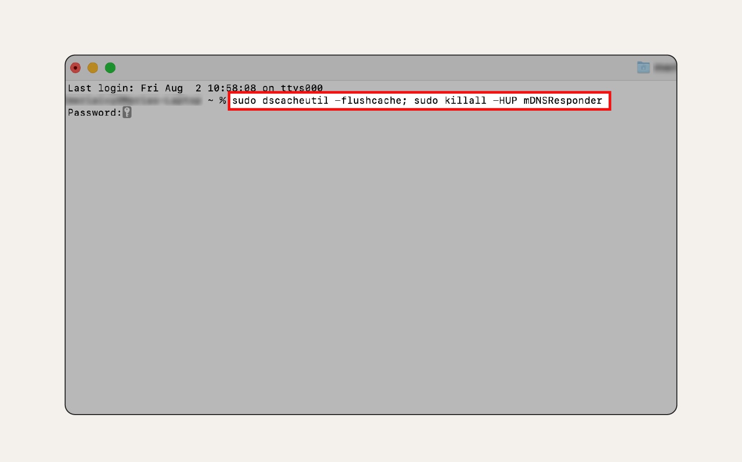

How to clear a Mac DNS cache
The Domain Name System (DNS) cache stores the IP addresses associated with domain names. Clearing the DNS cache can help resolve connection or website display issues.
Here’s how to clear your Mac DNS cache:
1. Open Terminal (Finder > Applications > Utilities > Terminal).
2. Enter sudo dscacheutil -flushcache; sudo killall -HUP mDNSResponder and press Return.
A screenshot of the code you must enter into Terminal to clear the Mac DNS cache.
3. Enter your password and hit Return.
